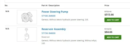

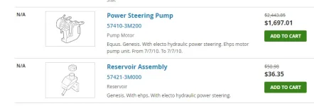

Just an FYI - Pentosin CH 202 with EHPS, and PSF-4 for non-EHPS (round reservoir)
