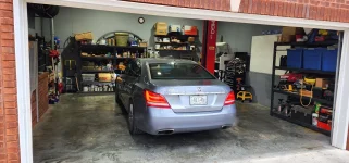

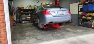

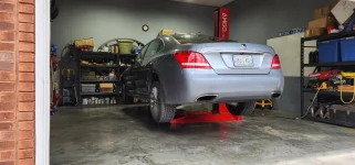

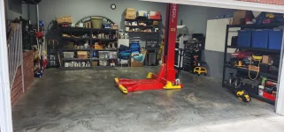

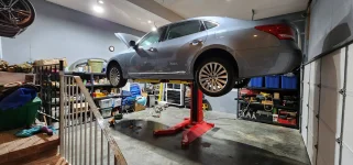

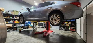

I just use the pinch welds when I lift mine.
