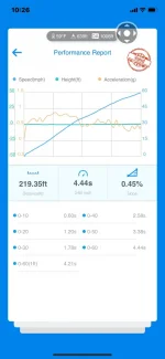

Yeah I tried that before using map 2 and hit the 4.40s as well. Are you AWD? Eventually going to get that TCU tune though. Another thing I noticed is that the car started to run slower & slower as I used MAP 3 and ~E30. Doing 100 - 200 @ 9.34 to 9.99 (funny number there). 0 - 60's went down as well on Map 3... 5.0's, which is slower than stock :/ I have the Denso plug's installed gapped @ 0.22. I just wonder if the car's(because MAP 3 generates more power) OEM TCU is hampering the tune to protect the transmission... but i mean in 3rd gear as well, not just 1st and 2nd...?
Anyway, as soon as I went back to E10 and Map2... BAM! 4.40's ... the car consistently runs in the 4.40's under the same ambient conditions on the same road same directions. So something with E30 this 2022 isn't liking... esp. 1st and 2nd gear. Again, E30 under same conditions was getting me 4.72 - 5.5 0 - 60s :/ E10 (California 91 Octane Panther Piss) & Map2 4.4 - 4.5's... go figure :p

Mine is AWD. By slower and slower do you mean when doing back to back pulls or over the course of days/weeks? I would expect the ECU to start pulling boost down to help cool things off, but that's not something I'd expect on a run with a good amount of wait between pulls to let things cool off.

No day to day ... same temps, same humidity (san diego is very consistent weather ... at least in my location) same trans temps, same road and same directions. I try to be very consistent with the testing conditions. I'll run 3 0 - 60 passes. I'll drive around for about 5 - 10 minutes between each pass to cool things down again. I'll also do 80 - 160 kph passes to get an 80 - 120 and 100 - 160 on a different day on the expressway by me... same exact area... so it's the same slope as well. The car lost its wow factor with E85... as soon as it cleared and I went back to map 2... it had that wow factor again... really pulled hard. So something with the 2022's that don't like too much boost/power... and i'm pretty sure it's the TCU hampering everything down to protect the AWD drivetrain. I know other's get ~ 4.40s with Map 2 as well. But E85 and you clocking over 5's? Something not right =)
Terry & I check the logs... everything is online... AFR, TRIMS (line up well within tolerance), timing, Boost, E85 load... all good. So it must be the TCU limiting the amount of power.
