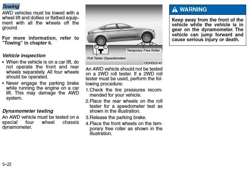

Here's to your towing question on the HTRAC:
Thanks for that update. Concerned about all the warnings and causing big time damage in a tow or dyno situation such as a smog check.

  • Alwaysforward has answered this already. Personally, I would always flatbed my car regardless of if it is 2WD or AWD.
