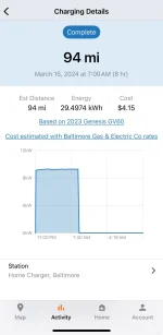

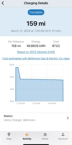

Apologies if this has been mentioned in another post or thread already, but has anyone noticed a change in Level 2 charge rates and curve? In the first few months of ownership, my '23 Advanced would reliably charge at the max rate of ~11kW on my ChargePoint home charger, but more recently it will charge at that rate for only ~20 minutes usually. Normally not an issue at all as it's overnight, but occasionally I want to charge up a little faster midday if/when needed.
Has anyone else noticed this on their GV60? I've tried the typical things of double checking ChargePoint settings and have rebooted it a time or two, and no other changes I can think of.

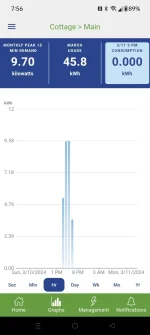

I'm not seeing that. Here are my last charge profiles.
Minute by minute and hour by hour

You might have the software fix that lowers the charge rate when it overheats. 48A 11kW charging overheats the charge port on many GV60/EV6/Ioniq 5s. There is a class action lawsuit for this.
The person above is charging at 40A 9.6 kW, which is also what I charge at.
Thanks for pointing that out, Grayson - that absolutely tracks. I'll lower my current limit to 40A on my charger and see if that solves it for now, or at least gives me 9.6kW consistently throughout a session. This feels like something they could probably adjust in software later still to be a little more granular with the rate and temp variability. The ambient temps don't seem to be a factor for me as possibly suggested on that class action page - many of those charging sessions for me were late night, around freezing temps outside.
Thanks all!
Quick update on my end - changing the current limit on my ChargePoint to 40 I got a consistent/non-throttled session. Reading through some other threads both here and on the IONIQ subreddits it seems like this is indicative of an issue that does get worse and not better over time. Hopefully the new recall announced in Korea makes its way here and can address the root cause related to the onboard chargers and ICCUs.
