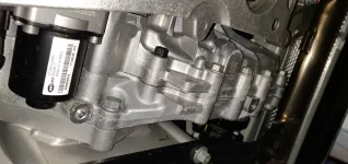

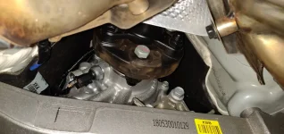

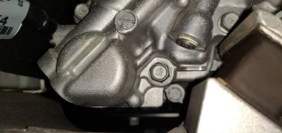

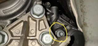

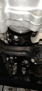

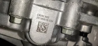

Just checked under my new G70. I am unsure if there is a drain bolt, but there is one possible bolt I'm seeing. Keep in mind though, it's such a tight fit in there that you may have to completely remove the case to figure out a way to re-fill it. And I don't even know if this bolt is high enough to refill it, or low enough to drain all of it...
Here are some really up close pics to illustrate. Sorry I don't have a gigantic hydraulic lift in my tiny garage.
Xfer case P/N?

Driver's side, rear facing portion of lower case...

Possible fluid access here, but doesn't seem low enough for a real drain bolt... This is the passenger side rear facing portion of the case. More likely this bolt is to hold something together inside the case, and isn't mean for fluid access at all.

Bottom of the case...

Rear prop shaft. Notice the rubber damper ring that attaches the shaft to the case.

And finally, front prop shaft.
18979
Thoughts....
First of all, the case is pretty small/compact. It really doesn't look like it would be too horrible to remove it. Would be a little more complicated than pulling a rear differential, but totally doable. That said, if you had to replace it, it's a job I would feel comfortable doing on my own. But, on that same note, at some point maybe it wouldn't be such a bad idea to try and service it later on down the road. You could technically split it in half without a huge hassle once the case is out and change fluids, but without a service manual I wouldn't dare do that.
