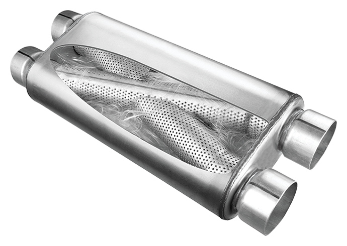

The correct X pipe will REDUCE drone, and not add. I bought a standard MagnaFlow X pipe at 1st, but was informed my exhaust expert to return. I'm glad I listened. I've changed my exhaust a couple of times. I started with the MagnaFlow mufflers. Last year I added a Dynomax X pipe which is built into a muffler. This replaced the OEM H pipe. This type of X pipe reduces unwanted exhaust frequencies (DRONE). My exhaust sound after this X Pipe install might be a tiny bit quieter, but the tone is better and the drone is reduced to a satisfying level. My YouTube link in my sig has a few video's. I will upload a new video with the X Pipe soon. I modified my exhaust long before any vendor manufactured a cat back system and at that time it was questionable if any one actually would make one. If I were to have a stock exhaust on my car I would purchase the MagnaFlow catback system and just simply add the Dynomax X pipe muffler in replacement of the MagnaFlow X pipe.
