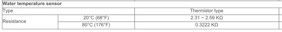

Sensor is located on the water pipe behind the left cylinder head. Check it for proper resistance using a ohm meter.
Part number looks to be: 3922038030 Check to make sure. I would stick with the Hyundai part, not aftermarket.

If it checks bad, I bet you could replace the sensor without draining the coolant. Have the replacement ready with Teflon tape wrapped around the threads and just hold your finger over the hole after removing the bad piece then quick whip the new one in. Toughest part may be getting your hands back in there.
Don't overtighten and break the casting!
