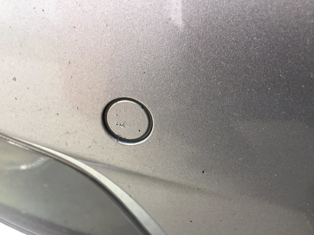

Yep, and I can order them for you directly from Korea painted from factory to match your colour.

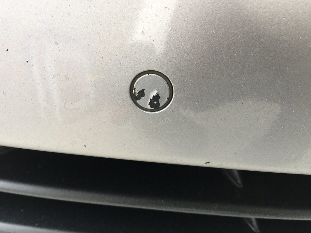

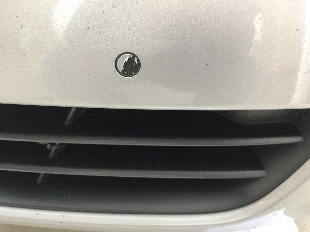

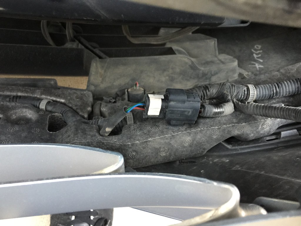

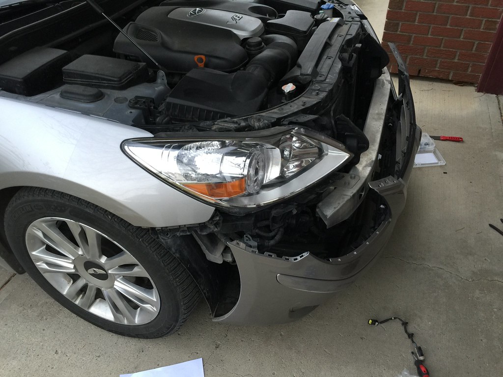

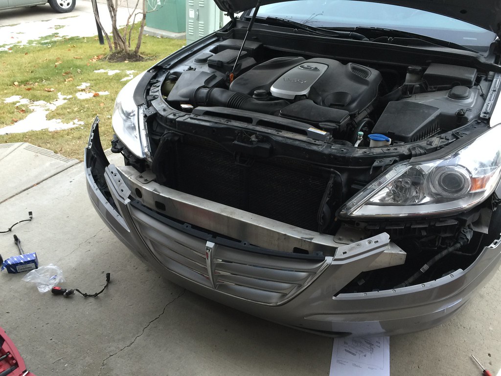

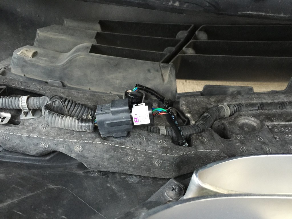

Installation for 3 sensors took me 1 hour (I have never done an oil change on my car before). Mine is also an '09.
Parking Sensor failure and paint also gone.
Just disconnect the connectors and connect the new ones.
(Old Connector)
(New Connector)
