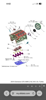

Hello I'm coming here for some help. My g70 is at 160,000KM mark and i got the dreaded oil pressure sensor light. I gathered all the parts and was doing a great job at tackling this. I'm embarassed to say i toghtened the new oil pressure sensor to the housing and it snapped the housing ☹️. I feel like an idiot and so mad at myself. I have ordered a new part 211603LTAO but I honestly bave no idea how to take this part out and can't find anything on the internet. I believe i have to remove the Coolant crossover pipe beside the oil pressure sensor but have no idea how to remove this pipe! Is it the water pump? Please help me!

The service manual calls that the "Water center pipe." I have the manual for the 3.8, but it is probably similar to the 3.3, as both use the 211603LTAO. The manual says that you have to remove the "water temperature control assembly" to remove the center pipe. There are several parts to remove first to get that off.
1. Water pump pulley
2. Water pump
3. Water pump gasket
4. Water center pipe
5. Water inlet pipe
6. Water outlet pipe
7. Water temperature control assembly
8. Electric thermostat (ECT)
Thank you I also found it in my manual I have a alldata plan and noticed they call for the engine to be dropped to remove The water temperature control assembly. I was hoping to unbolt the water temperature control assembly without dropping the engine and push it back an inch to possibly get the pipe out. Also, I noticed a video on YouTube. They removed that centre pipe to change the oil pressure sensor and it looks like the water pump is off. Perhaps the pipe can come off if the water pump is taken out.
