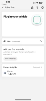

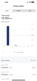

Personally, I got the Wallbox, see the UX/UI below:
5ED43171-0975-4D00-89AE-1397B22E0435.png0921BF09-52BF-4ED7-86C0-14327569026B.pngC4D1C0EF-34BC-448A-8B2E-03F634447B02.png2A74074C-A005-4009-9B38-FCB14851C2C8.webp
View attachment 53999View attachment 54000View attachment 54001View attachment 54002
