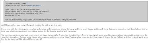

Also found this on the Gen Coupe forum
Purge valve caused a bogging down on my daughter's Santa Fe but not a starting problem. Have you has the codes read on the car?
