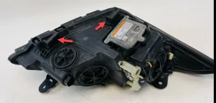

Looks like I have to remove the headlight assembly. No way to reach the bulb otherwise. I found the three bolts (I'm working on driver side) and removed them. Feels like something is holding in on the bottom but I can't see anything obvious. I loosened the bumper (but can't get it away from the bottom of the headlight assembly, afraid to yank too much as I don't want to break anything). Thoughts? TIA

Figured it out. Basically there are two hinges on the bottom of the headlight assembly and you have to bang it loose forward. I'll post more details later when I have a good set of steps

just some quick notes for you thank you do you have to release the top of the bumper that’s around the headlight in order for the headlight assembly to slide out After you remove the three bolts holding the headlight in from the top
By slide out I mean press hard on the back of headlight assembly horizontally wiggling little bit to get it to release the clips and it would then just pop out
I felt like I had to use more pressure on it that I was comfortable with at first.
After you get the headlight assembly out you can get to the two screws holding a bracket that holds the polls in place
