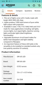

What makes these bad? Is there any danger of these causing other problems or are they maybe just prone to not lasting long?
I installed them about a month ago based on a thread on here that mentioned them working well, but recently there have been a few posts about the Sirius bulbs failing.
The description on Amazon described them as being good for turn signals and DRL's with dual brightness function.

Well, for starters the description is a terrible validation for the actual specifications.
Claim: 35w lamp
Claim: 1w 2835SMD chips
Claim: 1200lm light output
Fact 1: There's only 21 chips on these lamps. 21 x 1w = 21w ... somehow I suspect this 35w claim already
Fact 2: Epistar 2835 SMD is rated at 25lm per chip. 21 x 25lm = 525lm ... somehow I suspect this 1200lm claim already
Fact 3: Epistar 2835 SMD is rated at 0.2w per chip full drive. 21 x 0.2w = 4.2w ... wait- this is contradicting Fact 1 though! Surely the facts they presented are correct? Well, they COULD be correct, but it requires overdriving the chip 500% to reach claimed draw, but the actual output would only be 200% and they would fail very, very quickly. So you would have 1200lm per lamp and an expected chip life of less than 10 hours.
So you can't have it both ways. Either it's not nearly what they claim, or it's what they claim and has a very short life. Either way, it's a cheap bulb and a terrible design. They even use cheap capacitors to temporarily trick the CANbus system into thinking the turn signal has more load.
There's a reason why I installed Tritons instead of Sirius or any of those other less expensive options.
