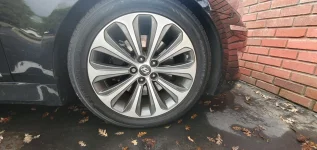

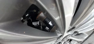

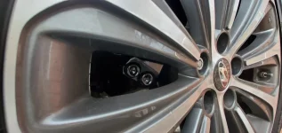

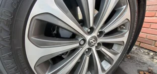

Hey OU.
Including some pictures here with the wheels back on. Quality and angle are not the best but it gives you an idea.
Overall, the job took my 3 hours with the help of my dad and wasn't bad at all.
We used a floor jack on the standard side jack-points and a jack stand for additional protection.
On the front, we started by compressing the four pistons and putting the new brakes back in. I cleaned the area heavily with brake cleaner and a solid wipe but made no effort to sand or anything like that.
I used plastic bags to mask off the surrounding area and taped the actual brake pad area behind the caliper.
I cut out a semi-circle in a piece of cardboard and it lined up perfectly with the hub of the rotor. This protected about 95% of the rotor, although there was definitely some overspray by the hub which ripped off when I bed the brakes in. I made one light pass and one medium pass with some high-temp caliper paint and let it dry for maybe a maximum of 5 minutes and then removed the masking and put everything back together and wheels back on.
Same story for the back except I did have to remove the caliper to compress the piston since it is a floating caliper. Did the same paint scheme on both the rotor and caliper, same dry time, and moved on.
Total shop time was 3 hours with about an hour of that being paint.
Overall, very happy with the results, I like the all black calipers and rotors and even though the front were black they now have a renewed look to them.
_Michael
