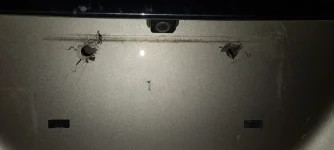

I hate to do this in the same thread, but does anyone know the part number or an easy method to put rear plates on the trunk? Right now the trunk has pretty large empty holes where the screws for the plates go. I think previous owner may have accidentally broke whatever was securing the screws to the trunk?20201212_175348.webp
If I recall correctly that rear panel on the trunk is pretty easy to remove and get access to the back side.
I'll look into that as well if I need to. Hopefully those plastic inserts will do the trick. The holes do look blown out though. I already have some JB weld for plastic so I may use that with the plastic inserts.
