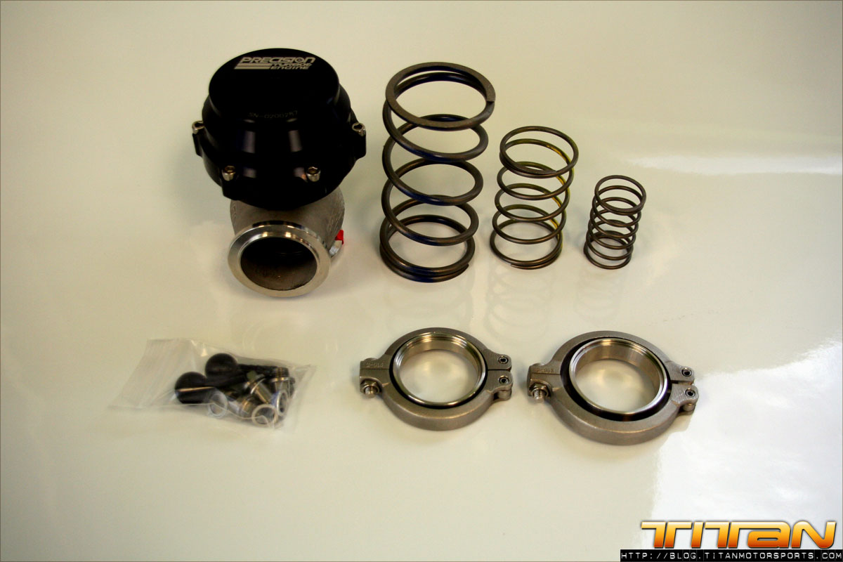

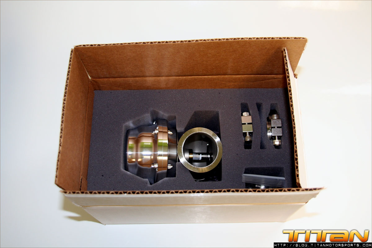

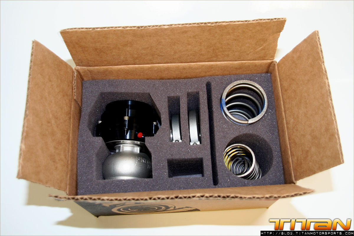

Below are the contents of the boxes the way they come, the clear difference is that the Precision comes with 3 extra springs in the box, that way you have the possibility to replace them without having to make a separate order for them.
As for the hardware, both have the banjo design, but the Precision brings an extra plug in case you don’t use one of the ports of the Wastegate and the Tial doesn’t have this in their hardware.

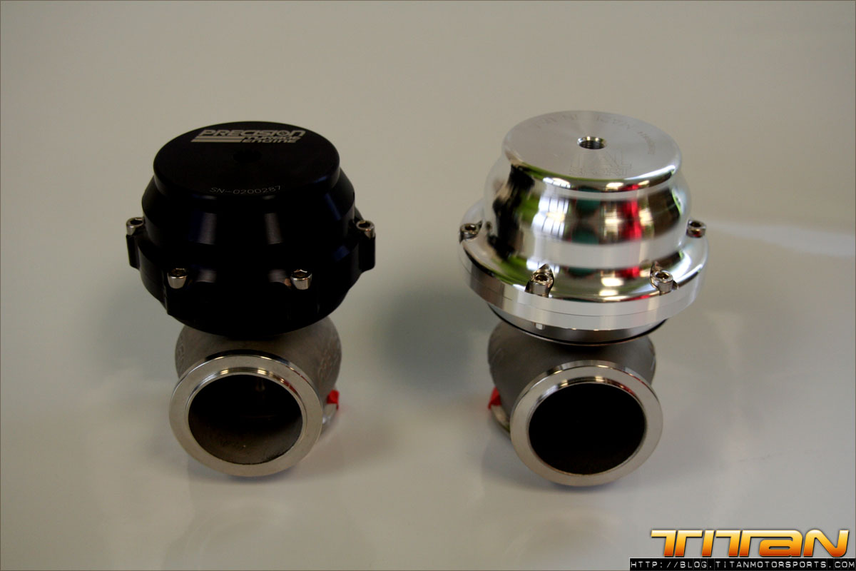

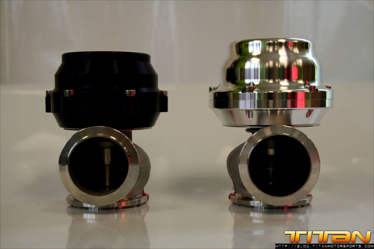

When side by side they look very similar, however the Precision unit is a bit smaller in height compared to the Tial.

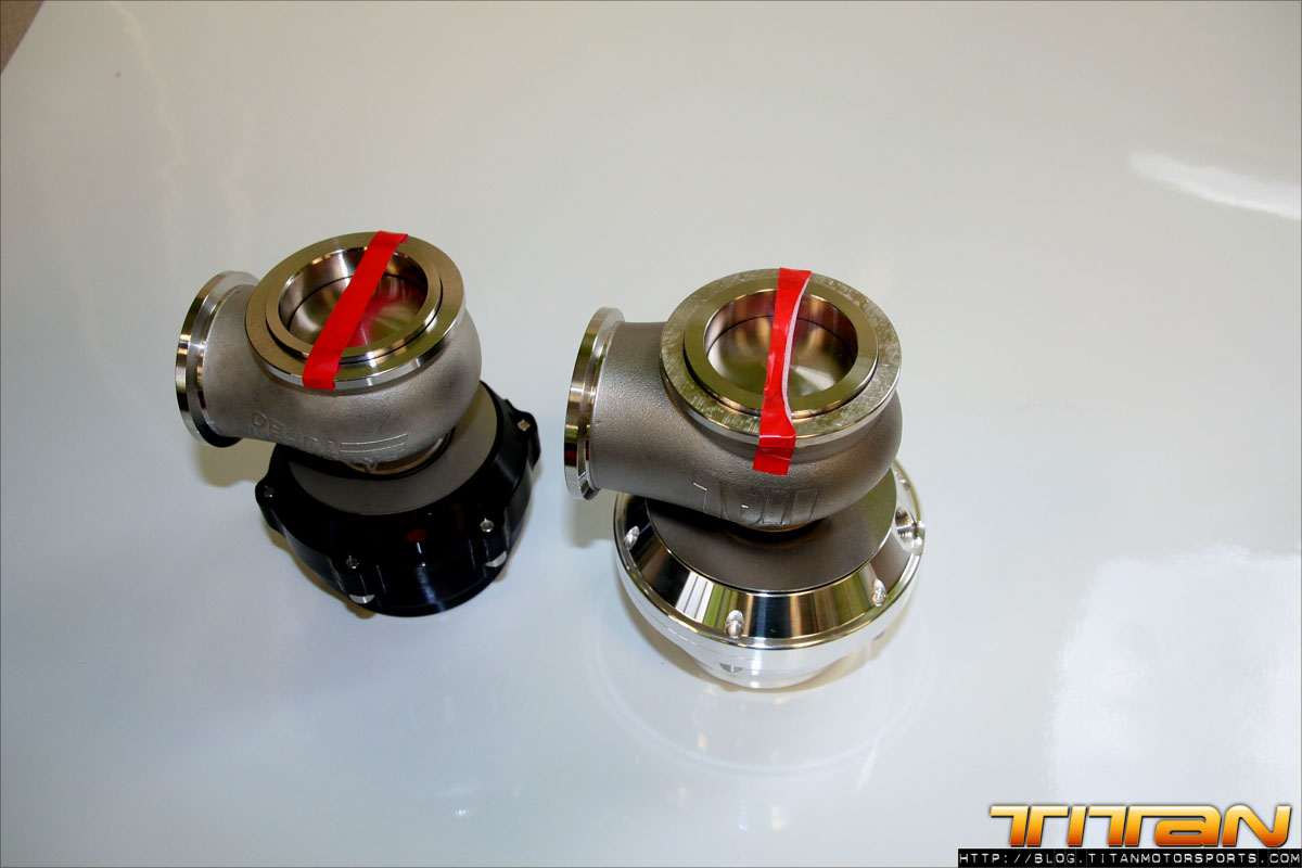

The underside again is the same basic design, however you can see how the valve in the precision is a little bit larger (2mm) than the Tial unit
Once apart, the precision comes standard with 2 springs, and the seat materials are visibly different, I ‘m not qualified to give a breakdown on the materials, however the structure of the seat itself is the same, and even though is hard to tell from the pictures they both use a 4 Allen key setup to hold the seat to the valve itself.
Internally the main difference is Precision uses a longer sleeve to hold the stem of the valve.
