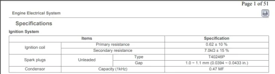

NGK HX Spark Plugs Gap 0.044"
Coffeeboss
Jan 4, 2021
2
1G Genesis Sedan (2009-2014)
The NGK website says that it is, but you could try calling NGK to be certain.
Can you just take one of your current plugs out or look in your owners manual for correct plug and gap settings.
