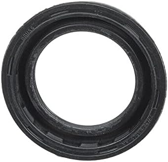

You see the shiny part above the bracket and below the connector? That's where the seal that is leaking goes. It's just pushed in. Nothing to remove to change it, other than disconnecting the wiring.
This is what the seal looks like.
This is a different engine and different location, but pretty much the same part and same leak.

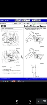

I gotcha. Finally had a moment to sit down and look at the service manual....Didn't realize it was on the upper timing cover...again it was something I caught in passing, I was more worried about the alternator cooking electronics with the P0626 lol.
Those seals look just like the oil tube seals on the valve cover of our odyssey, so I should be able to change them out pretty easy....The question is, Can I pull that front cover without taking the entire valve cover off?
Looks like If I take the 3 bolts off the valve cover on the front, I could remove the upper timing cover, swap seals, apply sealant to the timing cover, and sweet talk it back up under the valve cover gasket (and torque to spec of course :) ). Any objections to that?
I found this video of a guy man handling a 4.6 to remove the lower cover, but it gives a pretty good idea of how to remove the upper...He loosened the entire valve cover, but I'm pretty sure with some light prying action that front cover would come off with just the 3 relevant bolts pulled up out of the way. hmmm 🤔
Here is that vid
I don't understand why you are wanting to take the cover off. Doing that wouldn't help at all with this seal. You still couldn't install the new seal until you put the cover back on completely. If you are thinking that the solenoid itself is leaking or needs to be replaced, 99.9% chance that you are wrong. Just replace the seal.
As per the service manual and any other oil seal I have ever dealt with, the seal we are talking about is pressed in from the inside of the cover.... I know it is not the solenoid leaking. That was my initial thought when all I had to go off of was my own picture.
See this from the manual. Do you think the seal can be removed externally without removing the cover?
I honestly would like to do it without removing the cover. I don't like making things difficult for myself LOL.
If I am misinterpreting the drawing from the manual then let me know...
Sorry, that does look like what they did. That's crazy. AFAIK, everyone else does it the easy way.
