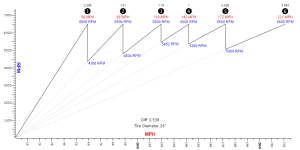

Using a gear ratio calculator, here are some before/after calculations in engine RPM....
3rd gear, 60mph
G70 FD: 4417 RPM
G80 FD: 4880 RPM
So the RPM difference would certainly be noticeable. Below is a shift point graph comparing the two...

If the gears actually fit (which I think there is a good chance they do), it would be awesome to see the change in 0-60 and 1/4 times. Hopefully somebody does this some day... Maybe if I were still single or my kid(s) were old enough to take care of themselves I'd do the swap. But, as of now, I simply don't have the time to take apart my car that extensively!
3rd gear, 60mph
G70 FD: 4417 RPM
G80 FD: 4880 RPM
Has to be good for the 0 - 60 times, but according to the graph it limits top speed to 200. Trips to the grocery store will take longer.
Oh don't you worry, the calculator I used only allowed up to 6 gears to be used. The graph doesn't show 7th or 8th. Those would be limited up to like 255mph or something. Haha.
