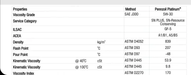

Thanks for all your replies. My dealership said that they used Pennzoil Ultra Platinum full synthetic for my oil change. I will most likely stick with it since it shows good reviews.
