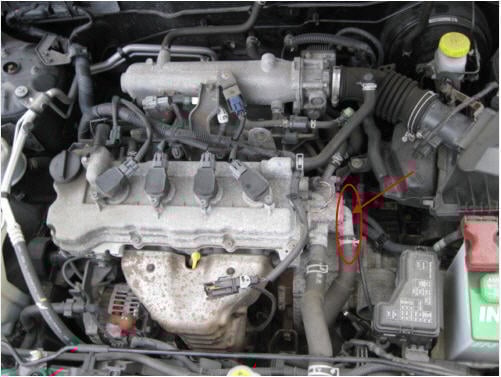

Ah. This is a bit tricky. They are mostly on top of the engine on most cars, but this one looks to be on bottom. The thermostat will be INSIDE part 9 mated to part 7. I will give a visual example below
That is for a Nissan, but you are looking for a similar looking housing with 2 bolts. Coolant WILL flow out just an FYI in case you wanna do this with the car warm or on a nice floor. Let me know if you need any further help :)
