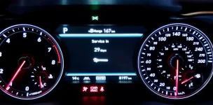

I was under the impression that the first scheduled service was at 10,000 Km or 12 months. My G70 is about 7 months old and just over 8000 Km so not close to either distance or duration of scheduled service. Yet I started to get this notification on the dash when I start the car.
Based on the amount of driving that I driving that I do I'll probably still be under 9000 Km in 29 days.
Has anyone else seen this?
Depends on how it was set originally at either the factory or the dealer. Best to go by the manual and set the alarm accordingly. It is not some magic engine analysis that is calling you, just a setting that anyone can change.
Check the manual according to the type of driving you do.

on the G80 (so I dont' see why the G70 would be different), that DIS warning is something YOU set in the DIS settings. Likely yours is set to some factory default.
mine popped up at 3,000 miles, but the G80 3.3T has scheduled intervals of 6,000 miles. I went into the DIS and aligned the setting with the owner manual recommendation.
please note, in doing so it resets the timer, so you might want to wait until you hit your mark before making the change.
