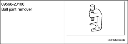

Looking to buy a good ball joint removal tool that works well with the front suspension of our cars. Specifically for removing the upper control arms from the front knuckle assembly. I rented a few from AutoZone but wasn't happy with how it cupped the underside of the joint, when applying pressure it would slip out or be at an angle. Those of you that have removed these when installing your suspension, what style and brand are you guys using? Tried to buy the one in the FSM but neither Hyundai or Kia are allowed to sell their tools to the public, something I had not heard of before. Attached is a picture from the FSM of the component and image of factory tool. Thanks in advance.

Try this tool looks close.
http://shop.ktcautotools.com/collec...all-joint-separator-tool-19mm-benz-vw-bmw-etc

Thanks that looks like it will work. And for $20 if it doesn't, no big deal.

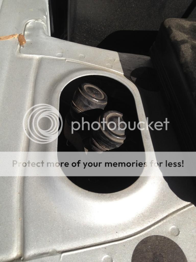

I had to remove them to install my air suspension. You cannot access the three nuts from the top cutout in order to remove the stock strut assembly. Assumed coilovers are the same way but have not installed any on our cars. The adjustment design is not that great since you cannot adjust the dampening while installed on the car. You can see why the ball joints have to be separated from the rest of the assembly in the last two pictures
I was able to remove the front struts without issue without a special tool. The IIRC, I accessed the nuts on top of the strut mount through the side when the car was on jack stands. This allowed enough room to get a wrench in there, since there isn't enough room to access from the top. I can post a pic if it helps.
If you don't mind sending a picture of where you accessed these that would be great. Not sure I quite understand what you mean by through the side. Did notice a hole up top but there wasn't three of them that I could see. Sounds like I might have overlooked something...

Ended up buying this removal tool, OTC 7315A Universal Tie Rod End Remover, off Amazon for $35 but have not gotten a chance to try it out yet either.
