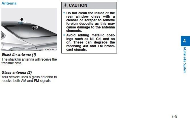

Have you gotten your windows tinted by chance? Not sure if this would affect it or not. I have no issues with my radio here in South Florida.
I believe all the antennas are in the fin on the roof.
Try disabling HD. See if you get a consistent standard def FM signal.
I agree. I believe what the OP is experiencing is HD radio signal kicking in and dropping.
The AM & FM antenna is imbedded in the rear window. As noted in the manual, it says to avoid adding metallic coatings (tinting)... as it will degrade the broadcast signals.
And it also says not to clean the inside of the rear window with a cleaner? So how are you supposed to clean it as it will get a haze/film on it over time?
