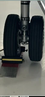

We built these ramps per the manufacturer to "ramp" the jet for wheel and tire changes. The first day we tried it and following the added stainless angled pieces for added protection.
