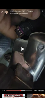

Here is a still from someone’s video(probably here) that shows the connection after he unplugged his. Looks identical.
