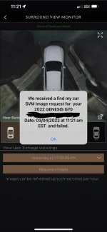

AAAC0452-0CE7-4DD3-A883-07F0D4226362.webpSorry if this has been posted before, but I’m having a problem getting Surround View Monitor to work on the app. It was fine up until a few days ago, first the mirrors won’t open for the picture now I’m getting a failed error (see picture). Has anyone been able to correct this on their own? I really don’t feel like going to the dealership. Thanks in advance for any help with this issue.
View attachment 43751Sorry if this has been posted before, but I’m having a problem getting Surround View Monitor to work on the app. It was fine up until a few days ago, first the mirrors won’t open for the picture now I’m getting a failed error (see picture). Has anyone been able to correct this on their own? I really don’t feel like going to the dealership. Thanks in advance for any help with this issue.
Easy fix to open mirrors. Make sure your inside left and right mirror adjustment is not set to the center. Same thing happened to my 2022 G70. Enjoy your surround view now.. Louis
