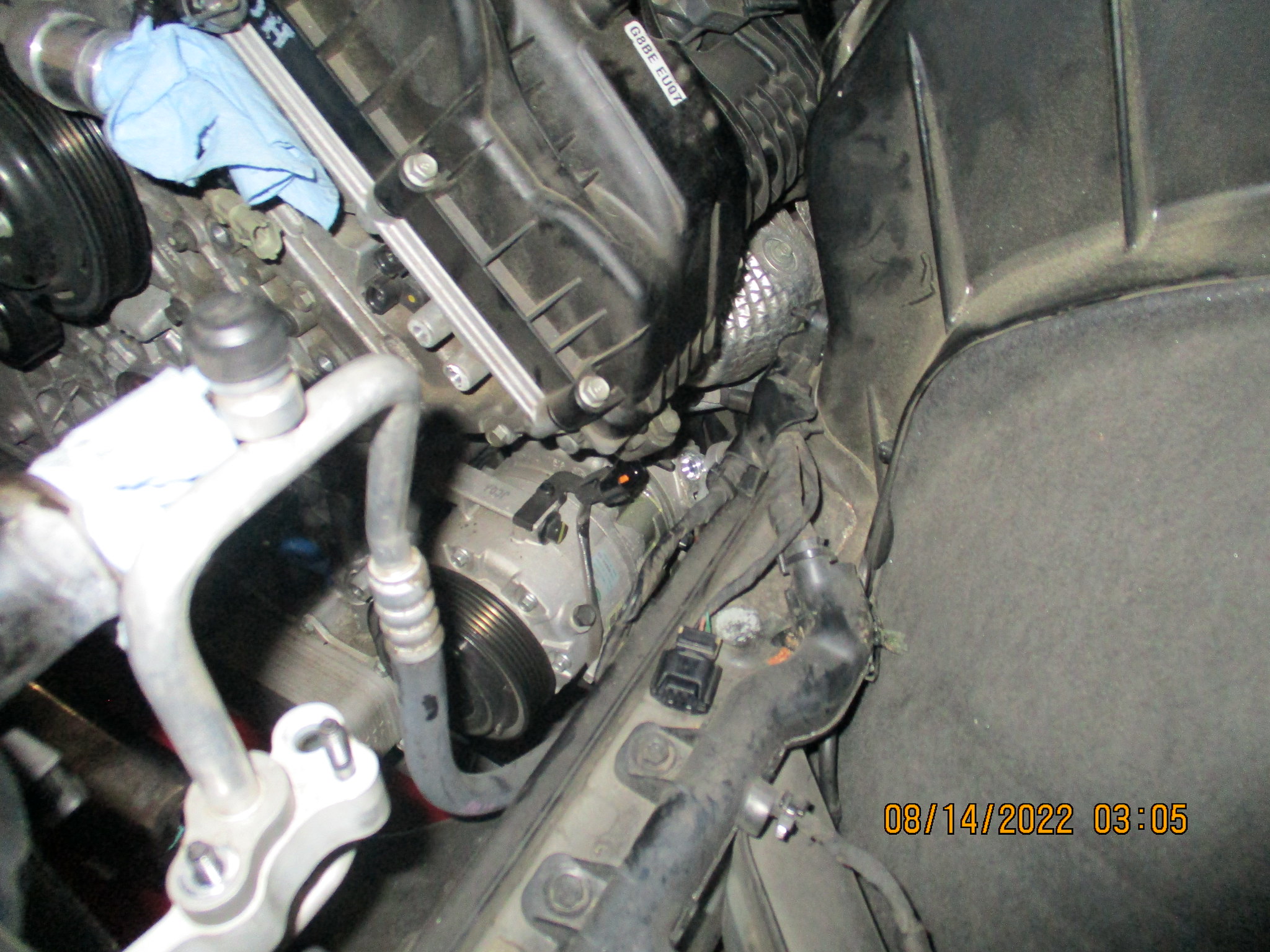

I removed my AC compressor to perform a lower timing cover repair on my 2015 Genesis and it is fairly easy to do on my Genesis.
Here the setup I used
