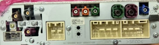

I recently embarked on a project to upgrade my Genesis G80's (AVN) sound system. I've acquired a brand-new AVN unit and a used amplifier, which conveniently came with its connectors(for the amplifier). However, I've encountered a challenge: the new AVN unit did not come with any connectors, as shown in the attached image
I've scoured various sources but haven't been able to find the necessary connectors, I noticed a similar, used AVN unit (with different part number) that includes similar connectors that I need (not exact but similar, as depicted in the
I'm now seeking your expert advice and insights on how to obtain the connectors I require for my new AVN unit. Do any of you have suggestions or solutions? like 3D print them or something:unsure:

you will need two kind of jacks one of them is HSD and the other is FAKRA
and if you end up purchasing the same AVN, you will need 2 jacks of HSD AND 7 Jacks of FAKRA (which I list above)
Screenshot 2023-10-27 135207.webpHowever, I am still searching for the same part number, but it seems hard to find !
