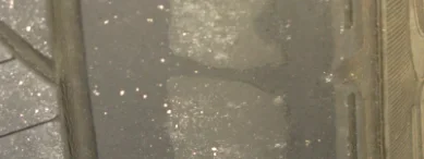

Here are photos of the outside and inside tread of the same tire.

888, these are the Dunlaps -- and I agree, they're terrible. Never thought I'd be looking forward to spending $1000+ on a set of tires. So your comment about Hyundai setting the camber to improve steering precision leads me back to one of my questions -- can camber be adjusted?
