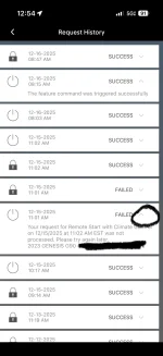

Go to menu on your app and check remote history. For the power on lines, click the down arrow and it will give you details.
Maybe that will help decipher what did or did not go wrong.

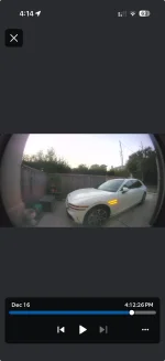

Uhh, mine never started and the climate never went on..... I did it the other day and when I got in the car was still running and warm. This am, got the text said that it had started , as I posted , and the climate said it was on. But the car never started and the heat never went on - car was stone cold. Like I said. The app said it had worked - which was wrong. PLUS, I have a ring right there and there was no activity on the ring - unlike - the test I just did. Don't have time to try and post the whole video, but here is a screen shot of the lights blinking before the car started and the heat went on a few minutes ago. This am no activity on the ring and no car startee.

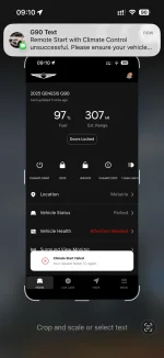

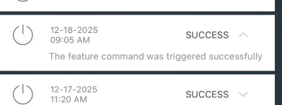

So this is another hiccup maybe. I submitted the climate start command and got this:
Then this:
But it was running when I got to the car.
So I thought the command has to be resubmitted upon failure? It just keeps on trying until success?

I do not believe it keeps trying. Because they only allow you about 3-5 attempts and then you get blocked for 60 minutes according to their messages. Not sure if that is 3-5 failures or 3-5 attempts regardless of starting.
My requests yesterday were very flaky. Kept getting failures and then was blocked for 60 minutes. Couldn’t troubleshoot to see if it was the parking garage, cell towers or the BlueLink network. I was in a new place by the time the block was lifted.
I think something was wrong with cell towers or Hyundai BlueLink yesterday around 5PM-ish Not sure what happened. All was good again this AM.
