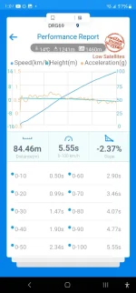

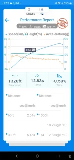

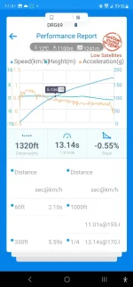

Here are some Draggy sheets. Not sure why they show invalid (limited datilite connection) but it's what I have for now. All runs in sport mode with launch control. Stock, 0 map, map 1 (91). Note the temp change and grade. Calgary is about 1050m above sea level.
