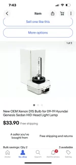

I bought these from eBay thinking they were correct:

What exactly are these? Halogen? Did all 2015’s have this style or the type as I originally thought I had?
So many questions
Yes, the bulbs you removed are halogen. 2015s had the option for either halogen or HID headlamps. I hope the seller lets you return the HID bulbs.

If you have halogen high and low beam bulbs, then your Genesis do not have a ballast. Ballast are only for HID light bulbs.
But, yes a bad ballast on a HID equipped car could cause low light output. However, HID bulbs can dim over time even with a good ballast.
