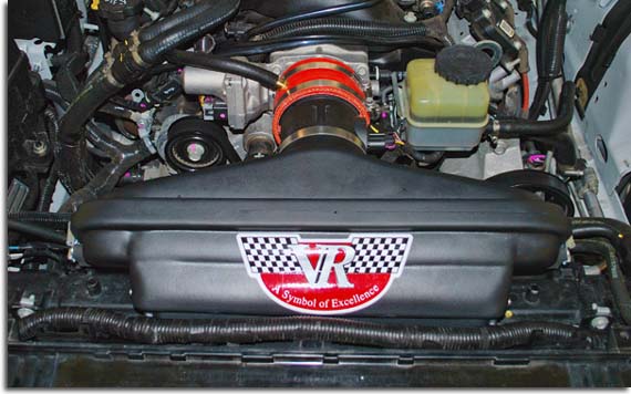

Yeah an OTR solution could work. Maybe someone could email Vararam and see if they would be interested in working on a Genesis? I don't know of any other mfgr that makes an OTR.
For those that don't know what I'm talking about here is an OTR system for a Pontiac G8.
