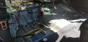

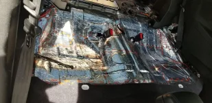

Just thought I would share. I just finished an upgrade of the audio and sound deadening in my 2013 GC. I was sick of the sound from the studded tires and other road noise. Ripped out the back seat, and side panels, along with the trunk. Used Noico 80mil from Amazon. It definitely was worth doing, and I'm happy with the project. I still need to finish the trunk, but just doing the seating area made a huge difference.
