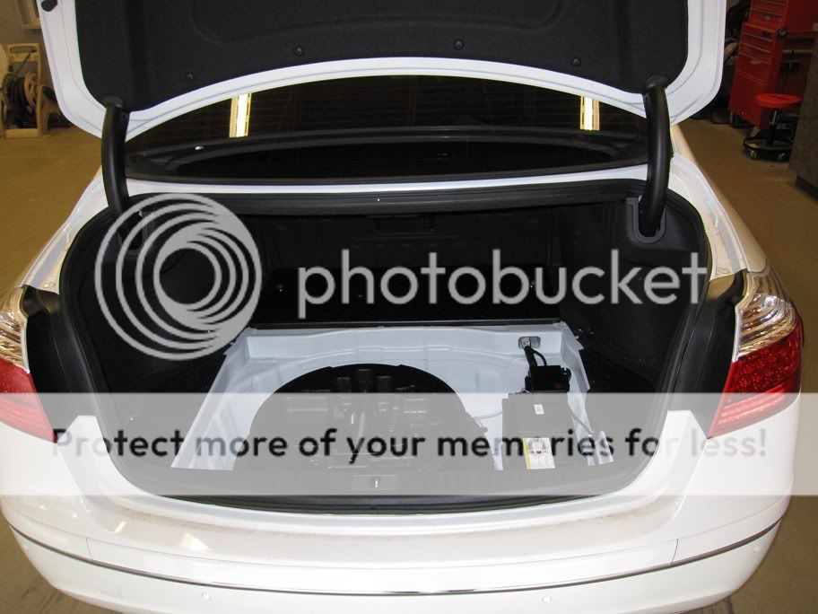

I finally did it. I have installed my sub of 15 years old in my Genesis and love the new sound.
The lows are finally present and the sound is amazing...There's an amazing rattling going on underneath the car that I need to fix now. Will look at it this weekend.
Here are the pictures that say it all:
This of course is my car...

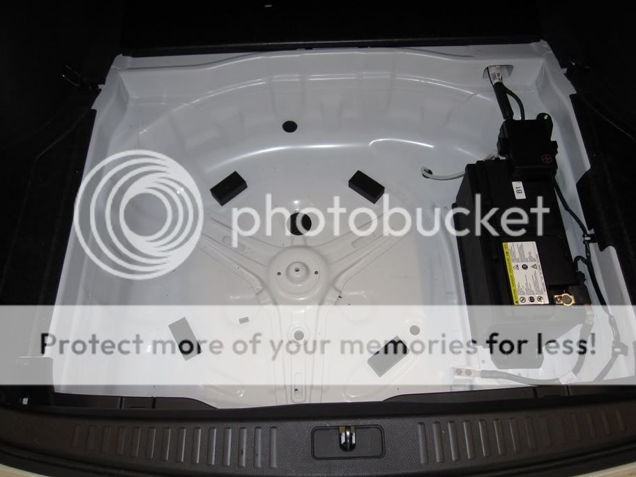

The trunk liner removed
The spare and accessories now gone...
The preparation of the 1" wood flooring
The box finished
How it fits in the trunk

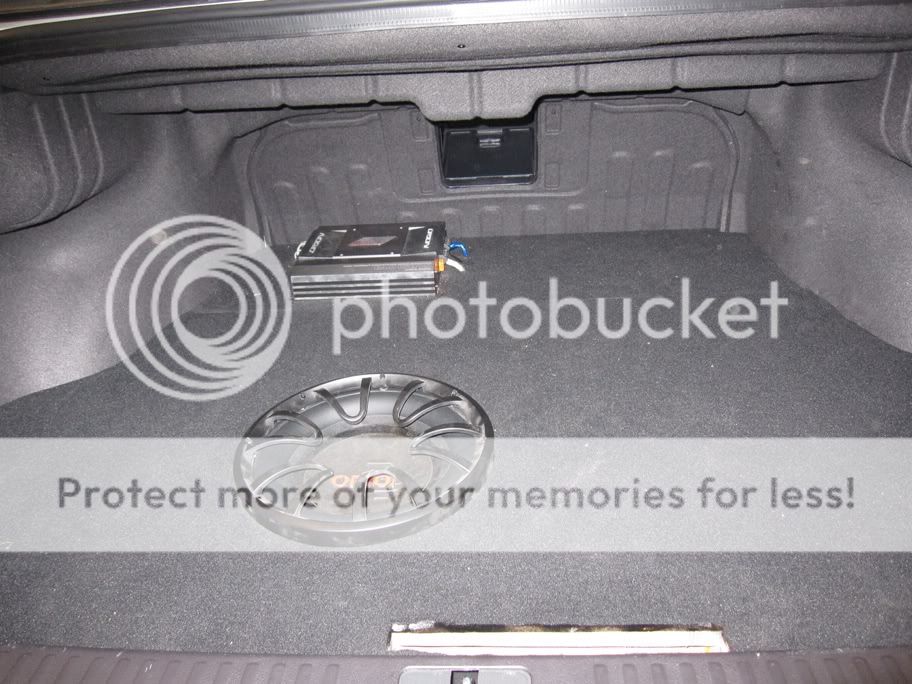

The amp and carpet installed in the back
The sub box installed with the side pieces installed on a hinge so I can fold them inward
The final outlook...everything installed and ready to go

Yes it seems pretty straight forward...
The sub input is connected to the existing sub in the car.
(low level converter)
Like this: http://www.skyinternational.com.cn/images/2111.jpg
Power is connected directly to the battery.
The remote is connected to a 12 volt acc. (I did not see this)
The connection is the easy part...the buildup of the box is the hard part.
Good luck and trust me it's WORTH IT BIGTIME!
The sound is AMAZING!!!!

In an effort to make sure I'm doing this right I've attempted to decipher the wiring in your picture.
The outstanding issues I'm still trying to work out are:
1) Where are you tapping into the factory sub's speaker line? Did you literally yank it our of the speaker, or did you splice in where the line exits the factory amp?
2a) Where and to what exactly is the remote line hooked up?
2b) What is the small black box on the remote line?
3) It looks like there are three wires running into the Hi/Lo converter. I know two of those are the positive and negative wires from the sub's audio, but what is the third?
Also, please let me know if I've mislabeled anything.
Thanks for your help!
WOW!!!
I'm impressed with what you did with the picture...yes you labeled everything right.
Here's what you don't see (don't forget I did NOT do the install, it was done by Car shop)
The wires that are connected to the sub actually go from the Hi/Low Converter (Left) to the right and then goes up to the sub
It's connected to an acc. in the fuse box. (Again, I did not see this but the installer told me)
I have no idea what it is...sorry
Actually there's 5 wires in all...
2 positives
2 negatives
1 ground
If you need any other assistance please don't hesitate to let me know...it is my pleasure...you'll love the sound output.

Is your factory sub still connected or did you disconnect it?
How did you mount the board in there bolt it in? or is it just kinda sitting there?
It's just sitting there...it's pressure fit against the back board where the amp is.
Trust me it ain't moving...it's really heavy!
IMO it will move only if I rollover.:eek:
I still have my stock sub connected:D
