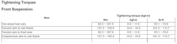

Hi Guys,
in the user manual is written that one time in the year the suspension mounting bolts need to be checked and tighten if needed.
Does someone has service manual which describes the actions of doing the check?
anyone know the torque on which must be suspension mounting bolts?
thank you!
