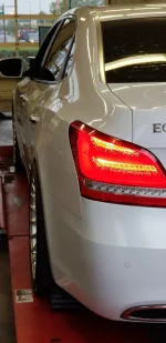

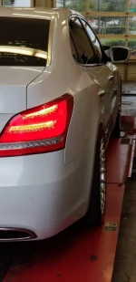

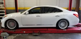

Here is my ride fresh off the alignment rack 20180815_184703.jpg 20180815_184822.jpg 20180815_184726.jpg

Stage one minor height adjustments to come. Need to take it up about .75" in the rear and 1" in the front
