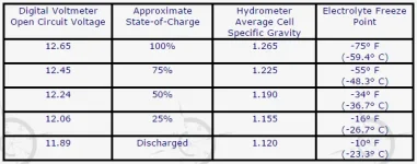

Here is a battery state of charge chart:

Recharge the battery and measure the voltage, 12.7v is fully charged. You should load test it to know if the battery is OK.
If you don't have a load tester, put the voltmeter on the battery and start the car and watch the voltmeter, it should not drop below 11.5v if it does your battery is suspect
