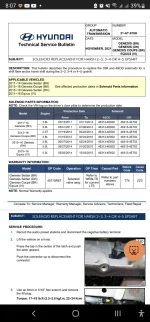

The mystery about transmission hard shift is finally revealed (TSB for HARSH 2~3, 3~4 OR 4~5 UPSHIFT)
Considering it is a completely different transmission in the 4.6 - I'm highly doubtful. The same trans is shared by the 3.8 and 5.0, starting for the 15 model year.
Dam, so is there no known way to try to fix this issue in the 4.6L? Cuz my 2012 4.6L is having the same hard shifting issues as the others....
Agreed. However regardless of the type of the transmission, hard shifting is attributed to a number of things, starting from ATF issues, clogged filter, solenoids, worn valve body all the way up to internal transmission parts... I recommend approaching the problem in the above sequence.
