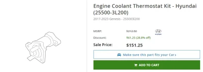

If you are beyond the original warranty period Genesis won't cover it. The part is available from Hyundai (~$200) so you could buy it and take to a local shop. Don't think Hyundai and Kia dealers are allowed to wok on Genesis.

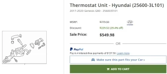

Thank you, Speeder. The TSB has the part you provided but looking at my estimate, they want to replace the entire Thermostat housing. I'll need to ask why for a 36k vehicle that's not overheating.
