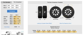

In general, you want to stay < 3% diameter differential of the OE tire size. 245/50-18 is just over 3% larger than OEM:
Having said that, if you don't care about speedometer accuracy, then it's fine.
