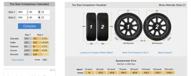

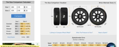

So these should work… depending on true fender clearances. Thoughts?
