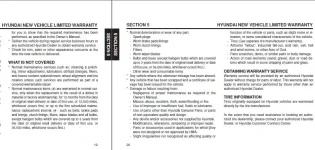

Sorry, not trying to be a PITA, but just providing one more bit of info. From the 2012 Owner's Handbook and Warranty Information, in the section titled "What Is Not Covered":
- Any device and/or accessories not supplied by Hyundai.
- Modifications, alterations, tampering or improper repair.
- Parts or accessories used in applications for which they
were not designed or not approved by HMA.
Seems to me that "what is not covered" does not equal "will void warranty." Likewise, "not recommended for towing" does not equal "will void warranty if you do," especially since the owner's manual also explains how to properly tow with the Genesis.
