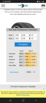

After some investigation I found that the front tires are supposed to be 225 and there are 235s installed. It's only 1" difference but equates to 10 more revolutions/mi. I suspect you're correct that the tire size difference is the culprit. Looks like I'll be buying 2 front tires for my car to see if that fixes the issue. Thanks

Yes, I know it's 1 CM in width but translates to 1" difference in circumference. See screen shot.

The diff in diameter between your front and rear may be the issue. Width doesn't matter. Diameter does and right now it is out of spec vs your rears.
Stock setup has the diameters at .4% difference. Right now witht he 235/40/19's on teh front and the 255/35/19's on teh rear you are at a 1.5% difference. May be enough to set off the TC.

Fixed it! Yeah it was the tires. The collision avoidance alarm goes off sooner now too. I'm guessing bigger tires are fine as long as they maintain the correct ratio with the rear tires.Thanks nameneeded and others
I guess that one extra inch DOES make a difference!🤷‍♂️
For sure. Glad it's fixed. You can have different widths, but not diameters with AWD.
