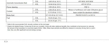

Does anyone use a specific transmission fluid oil that is good for the 2009 3.8 Genesis? Which brand is good? Thanks for all opinions
Based on this 2009 owner's manual page:1681767089139.png
...it appears that the Aisin fluid on Rock Auto's site meets spec:
per their statement (my bold):
OEM / Interchange Numbers: 0023219016, 00289ATFWS, 0888602305, 19256039, 31252774, 83222355599, 88863400, 88863401, G055540A2, NWS9638T5, SOA427V1300, WS

Not to be a buzz kill, but according to post #2 owner manual post; I would not use that Redline transmission fluid as it does not list the factory fluids in the owner manual as being compatible. I would check Redline website first.
I’m going with Aisin fluid. It meets all of the OEM specs
