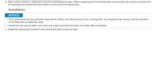

The most likely possibility here is that the windshield was replaced with aftermarket. What is the writing on the windshield?

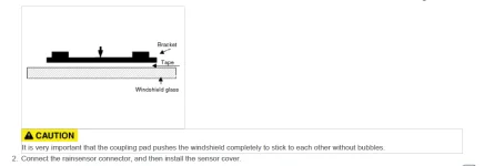

The 2nd possibility is that the sensor is not correctly attached to the windshield.
3rd would be that the LED on the sensor is at or past half-light (sensor needs to be replaced).
The sensor shoots an IR light at the windshield at an angle. There is an IR receiver next to it also at an angle. When the windshield is dry, the light reflects back into the receiver. When a droplet of water is on the windshield over the sensor, it changes the angle of refraction, such that some or all of the light does not hit the receiver. Rain-X can interfere with detection by causing droplets to slide away from the sensor too quickly for it to see them.

The windshield must have been replaced by the previous owner. It doesn't have the Genesis symbol like his other glass.
However, on other vehicles we've had the windshields replaced that have smart wipers, adaptive headlights, etc that all work fine after windshield replacement. They did charge an extra $250 to "calibrate" these items. Not sure what is required, if anything for windshields with sensors behind them.
How does finding out if the windshield has been replaced helps differentiate between an LED sensor failure vs. other possibilities mentioned above?
It skews the odds. Some aftermarket windshields are good, and others are not. It wouldn't hurt to pull the cover off and see if the sensor is correctly attached.
