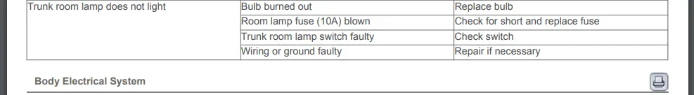

Check the engine compartment "ROOM LP" aka room lamp 10A fuse, et al...
Thanks! Done! Apparently “Room“ is broken English for ”interior“ or perhaps “cabin”. The fuse is in the engine compartment fuse box on the passenger side behind the box with the main battery fuses and jump start terminals. 10A.
I want to thank this forum for sure. I finally found the answer here. I added 3 massive LED lights into my trunk and 2 of the wires connected and pow went the fuse. I just could not find "Interior lights" or "trunk lights anywhere" Room light it was. The fuse was under the hood on the left hand, or passenger side fuse box. it was over to the left about 3 down on the first row. Thanks again. DC 14 Genesis 3.8 modified with exhaust. Fun car!
