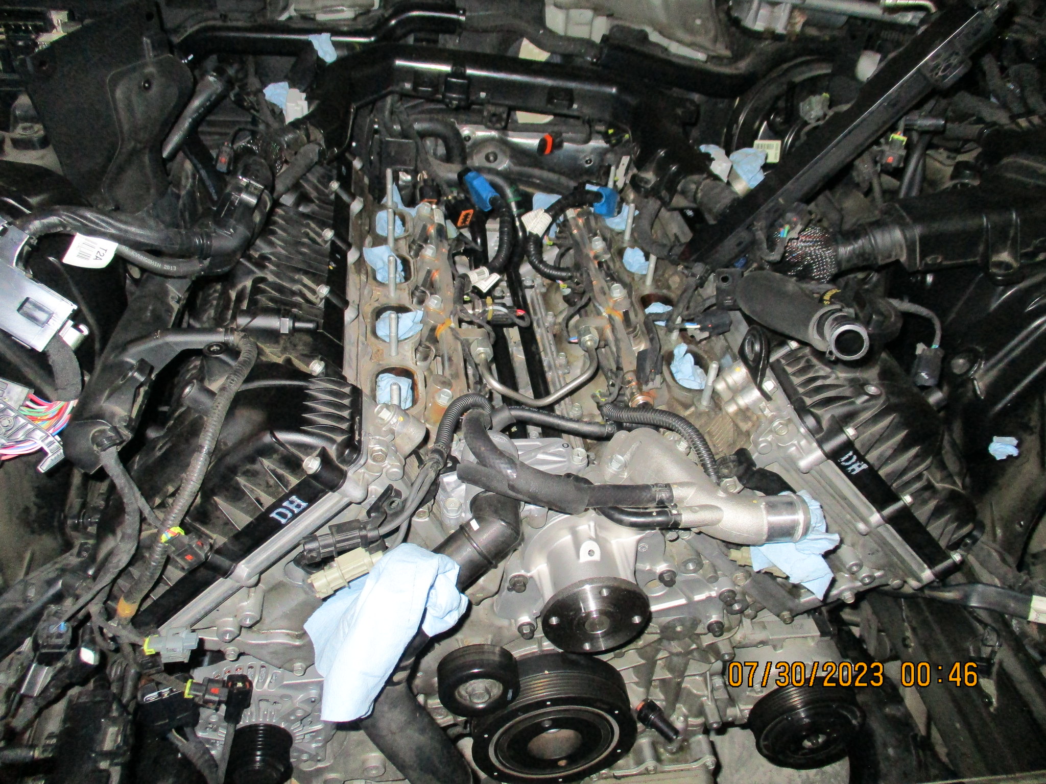

I did not notice an oil temp sensor on the valley cover, but I could have over looked it. It also possible to have a valley cover oil leak as well that could run down the back of the engine. The problem with modern engines is that there are many places for leaks to happen that requires major disassembly to even inspect the engine properly.
My old 2015 5.0 valley area.
Thanks! Agreed on the potential for leaks. If I get this resolved I will let you know what the leak source was.
I started to take the car apart to get a look at the valley, and it seemed to me it was going to be very tough without at least having the transmission removed, if not the engine. The high fuel pressure line and a mounting nut are both in a location that really isn't accessible otherwise.
